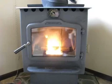

As far as I know they come with the stove. I've never seen a P series Harman without them. They help protect the back wall of the stove and help keep heat away from mechanicals. There should be a small channel above the burn pot for 3 standard size fire brick to sit on.
You can kinda see them in this pic. I know the stove is dirty I took this pic after 2 weeks of running without opening the door just to see if it would.
