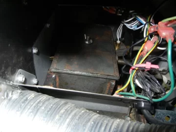

Where is this fines box your mentioning?
From control side above the convection fan. [Hearth.com] Harman P68 install, rear clearance for servicing? No fan in this pic.
Reactions: rayttt
Thanks...next shut down ive got to go and look..
Its been 4 years since I got that stove ...think its full? ;)
That's a loaded ?
