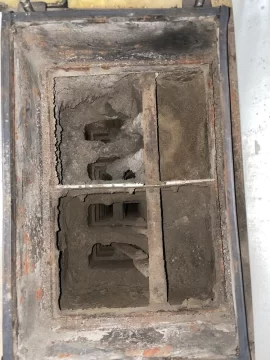

Below picture/video of how a pellet boilertubulators looks like after not cleaning of 4 or 5 years.
Pictures are not from the same boiler

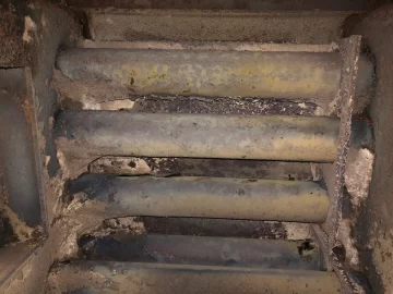

And here's a photo of the innards, for what it's worth. We did get the boiler going and it seemed to be doing pretty well until we found a quart or two of water over the floor. The dealer thinks its a faulty pressure relief valve (since the pressure seemed to be in normal operating range, about 10 psi). The theory about the heat loosening up the rods hasn't proved valid yet.

The heat exchanger tubes are badly choked with creosote and ash. It probably was run at too low a temperature, which produces condensation and creosote. The temp of the water jacket should not drop below 140F when it's burning. Keep it hot and it will stay clean.
You might try heating the plates that scrape the tubes with a heat gun or propane torch to melt the goo. Creosote can be corrosive, so having that kind of buildup is very bad for the unit.

The rods are attached to vertical plates that slide over the heat exchanger tubes to scrape off loose ash. Looking at the photo you uploaded, you can see one of the plates on the right side of the vertical heat exchanger tubes.
I agree that the first thing I'd do is lube up the bushings that the rods pass through. Creosote and ash as well as rust can gum them up. I try to use some kind of heavier lubricant on the rods at the end of each heating season so they don't get stuck over the summer.
In the photo, you can see the range of travel the scraper plates have by the large buildup at each end of the heat exchanger tubes. The scrapers are something you should use every day or two, but the boiler requires that you go in and clean off the stuff the scrapers miss every month or so. I usually run a wire brush over the interior walls of the boiler and (very important) clean off the combustion fan blades, the backing plate and the chamber the fan sits in about every six weeks or two tons of pellets (I burn hardwoods). Keep that combustion fan area clean and you'll enjoy the boiler a lot more.

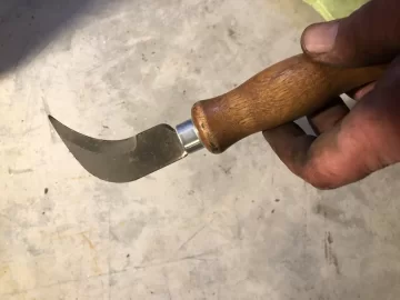

  • I've had success freeing the rods, understanding how they work and cleaning the innards. The rods came free with a couple of doses of WD40 followed by some bangs from a plastic mallet. When they came free, I could see how they cause the scraper plates to move. I've posted a video below for anyone getting to this thread from the internet with the same questions as me. Plus, the previous owner left the curved tool (see picture) that PERFECTLY fits over the exchanger tubes. That, plus a wire brush and vacuum got them pretty clean. I also cleaned out the combustion fan.
Interesting “tool.” It sure looks like a linoleum knife to me. 😂Neccesity is the mother of invention, or perhaps we should say the mother of repurposing here. 👍🏾
