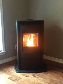

I just had the Allure50 installed yesterday. My set up is just like you are getting. Corner install with 45 degree to exterior wall with upward turn outside. Here is my installation cost breakdown:
Labor $450 (2 man job)
Harman hearth pad $215 (dealer honored price he originally quoted me on Accentra pad even though I changed my mind and went with allure.
Pipe and materials. $438 (I did go with a 4 way pipe outside for easier cleaning of pipe.
My total for install was $1103. Hope that helps. Here is a pic.
Jeff
