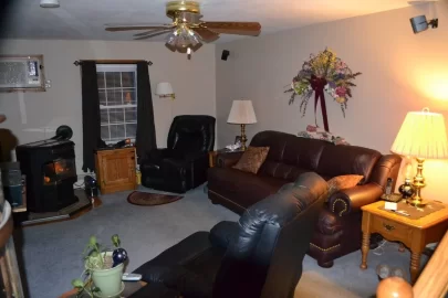

My temperature sensor Is on the plug wire of the light that Is lit.I ran It under the floor 20 feet away from the stove
Stove set at 70 deg. and the room temp. will stay at 70 deg.+ or - 2
