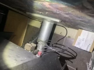

Mine sits behind the stove and keeps my place within a couple degrees of what the stove reads....P61
  • [Hearth.com] Harman Room Temp Sensor Placement?  Thermostat?
probably cannot see it but it is peaking out on the left side of the top of the hopper right behind the harman tool.
