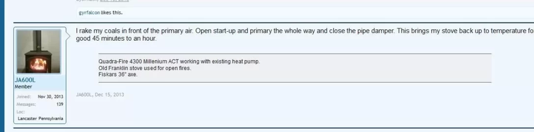

Your ACT is very different from the ACC they are making today. A tree guy who does all my work cautioned me against buying a Quad 4300 in December of 2009....he said they had cheaped the stove out. I disregarded his advice as it was a Quad, what could go wrong? Fast forward to today where I have an Ikea stove that cost six times what you paid for yours and mine squeals, rattles and rusts. You haven't mentioned that you added a damper to control your stove. I met and did business with Dane Harman. Dane's stoves put Quad to shame.
