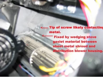

Today (1-17-06) the Harman Rep himself came to my home and worked on the buzzing noise coming from the distribution blower. It has only been about 1/2 day, but I am pretty confident this fix worked. He took the back panel off, as looking at it from the rear on the right side and immediately above the dist blower, he isolated the buzzing sound as eminating from the shroud immediately above the distribution blower. On the right side (as viewed from the back), there are two pieces of sheet metal (see photo attached) which I believe they call the shroud. The two sections overlap eachother and are attached by a sheetmetal screw. Their is a slight factory bend in these overlapping sections (I guess to help deflect the blower air up and into the heat exchanger. The Harman Rep (and myself after watching his method to isolate the sound) believe that the tip of this screw which joins these two sections of sheetmetal was just barely touching a piece of metal behind it (I believe a section of the the distribution blower housing). The fix the rep came up with was very simple, he wedged a small piece of stove gasket material immediately behind the this shroud where the screw was contacting whatever it was hitting. This was enough to keep the tip of screw from contacting metal behind it. With the dist blower at high, it apparently was enough to cause a high frequency resonant vibration, causing metal (the tip of the screw) to contact metal (I think part of the dist blower housing) and make the buzzing sound. Wedging the gasket material behind it apparently kept the screw from contacting the the metal behind it.
After 4 visits, 3 by the dealer tech, and 1 by the rep himself, I think it is finally fixed as it hasn't buzzed all day. This stove now acts like a $3k stove should.
I am now a happy camper. Thankyou Harman for standing behind your warranty. I now like this stove (ok' love this stove) as much as the fist day I saw it in the store. No more buzzing.

As for the buzzing.......THERE IS A FIX.....its the sheet metal shroud around the distribution fan....it resonates....it can be gasketed to stop the vibration, but if its not done right and tightened well, it'll recurr. My marketing rep sent me pictures on how to rectify it, thanks to them....you know who you are, Charlie. Really, go to the delear, see him face-to-face......demand satisfaction.....
