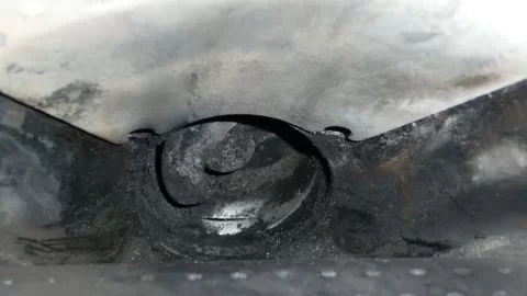

I was cleaning my burn pot and notice this gap, never notice it before. Do I need to contact the Harman dealer?
I have been noticing more ash also.

That definitely doesn't belong there. Here is a pic of mine for comparison.
Would call the dealer.

Thats what I was afraid of, now I am going to have to fight to get it fixed. The stove shop that I bought mine from no longer sells them so hopefully the new dealer here will come out and fix under warrenty.
If they won't fix it under warranty ,I would try a little jb weld. It wouldn't hurt to try. Go easy scraping the pot around the repair. Sharpen the tool that came with the stove and stay away from the hammer and screwdrivers that some use.
Looks like the dealer is going to help me out, they are sending the pics to Harman to see what they want to do. Also when I went on the Harman site and looked up dealers in my area there are 12 listed, I guess they are doing away with only buying from a dealer in your territory. :question:
