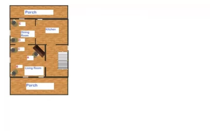

#2) Where's the best place for this thing? I am going to try it first in the existing fire place in the living room located in the center of the house. I am worried about it blowing towards the outside of the house rather than towards the middle for better air flow. Not going with an insert so I can move it to an outside wall in the future if it doesn't quite get the job done and put a woodstove in the fireplace for those sub zero nights. I have attached a diagram with the only location options.

Looks like position B would be the best spot. And you'd be blowing the hot air into interior rooms, rather than an exterior wall.

I agree with position B. It gives both convection and radiant heat a shot at the rest of the house and upstairs too. I wouldn't be quick on the vents. Pellet stove convection fans push a lot of heat around. I was concerned about upstairs too(1800 sq ft with p61) and ended up running the stairway ceiling fan pushing down the stairway. Upstairs was fine for sleeping, even on the warm side actually, though my stove position has a fairly straight shot at the stairway.
I agree with position B, but would also consider E as well. The advantage of E would be that, you wouldn't hear it as much while watching TV. I think both would work fairly well at getting heat upstairs. I would certainly wait on the vents until you try the stove out. We don't use any vents in our house, and our XXV heats the upstairs without issue. You mentioned the house is tight, and that is the biggest factor to consider. We seem to be much better off than most, having only used 2.5 tons this year heating 1900 sq ft, but our house is pretty new and well insulated. We certainly could have gotten away with a P43, but that may not be the case for you. The P series are easier to clean and service, but the XXV is pretty easy already. The only thing I don't like about our XXV, is how quickly the glass gets dirty. From what I have seen, the P series glass seems to stay cleaner quite a bit longer. But the XXV is quieter. If you decide to keep it in the living room, I would definitely go with the XXV. And you are much better off buying too much stove, than too little.
B looks like your best by bet. Either stove I think will do it. The P series stoves are a little easier to clean.

Agree with position B. Either stove should be able to heat your place without a problem. I also agree with another post to hold off on the vents. I wanted to put floor vents in my place at first, but quickly found out that the heat does a good job of getting up the stairs without any help. Glad I didn't rush to cutting holes in my ceilings/floors. Here's a hint: hold a candle/cigarette lighter/match while standing on the stairwell. With the stove running you'll probably be able to see the flame "lean" towards upstairs indicating you're moving heat.
Position B looks good to me too. I live in northern Maine and I am heating my 1500 square foot, 2 story, loose older home with a P43 no problem. Stove is set at 70 degrees room temp manual. It's keeping the downstairs at 73 and upstairs is 67-69 depending on the outside temp. We are loving ours.

I like B or E since they can direct heat into adjoining rooms. I would select either one depending on the direction of prevailing winds.
i've always prefered the B position myself
that's my choice also

If it were me it would be B.
