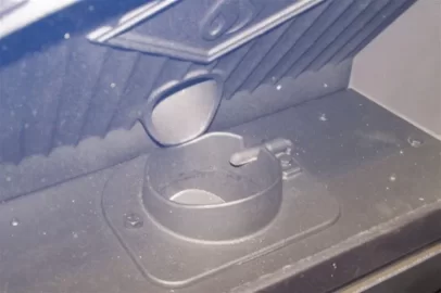

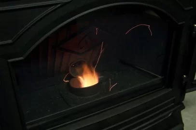

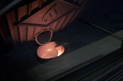

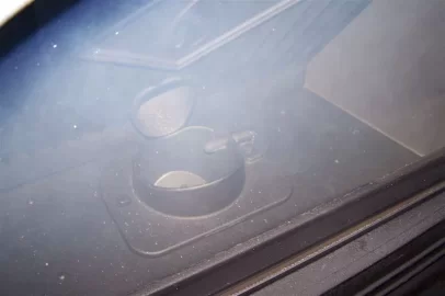

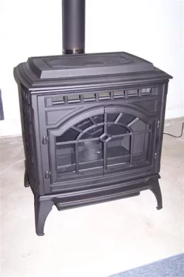

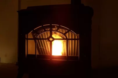

We got the stove all set up today, plumbed it in and temporarily routed the thermostat across the room. We took some pictures because we knew the stove was Never Ever going to look like this again (with our 'gooder' camera).
The stove slowly woke up and came to life with quite a few strange stumbles at first, but we eventually got it to breath its first breath after about 20-30 minutes of scratching our perplexed heads. One of the more comical stumbles happened when we finally got the stove to manually burn some pellets, the dang thing started an autoclean cycle completely at random. The barely burning embers were all dumped into the ash pan as if the stove was defiantly and stubbornly refusing to light.
One thing that made it so difficult to diagnose the situation was that the stove is SO quiet. It's barely audible. The only time you notice anything is when the convection fan revs up to a higher speed due to a larger flame in the pot (we have the system on 'automatic').
Long story a little shorter, we've spent most of the evening enjoying our new Quadrafire Mt. Vernon AE with nothing but satisfaction. The only wish we realized after the installation was complete was to have known that there is an optional kit to convert to a top venting exhaust instead of the standard rear venting exhaust. We very much would have liked to be told about this. Oh well, I'll call the dealer and see about ordering it. Then, it will just mean tearing down the chimney and starting over. Grrr. This kit will help us to get the stove closer to the wall and have the chimney centered behind the stove instead of off to one side.
Enjoy the pics and have a warm winter! Thanks to everyone and any questions are welcome.

And I thought the 1200i was easy to clean. The new Mt. Vernon looks really slick. They've cleaned up the interior of the stove a lot compared to our 1200i.
Congrats Chris. Good luck with your new stove. Looks great. BTW, you write very well. Was fun reading your saga.
That top airfoil is all that has to come off to clean it. It pops off with two latches, you just jam a screwdriver in and rotate. Way easier to clean that previous pellet units.

6- Regarding the 20-30 minutes of startup woes, this all happened because when I plugged in the power and the stove began the startup procedure (automatically), the ash pan was ajar. After the automatic pot cleaning cycle, the electronic controller gave an error message telling us the ash pan was not in correctly. We fixed that but the system didn't seem to have the ability to recover or get back on track. To the defense of Quad, if we had just installed the ash pan correctly, the stove probably would have started right up. I eventually unplugged the stove and started from scratch, hoping it would behave normally and it did. Everything worked fine although we did have to induce the fire manually just by putting a handful of pellets in the burn pot. The stove did the rest.

You kinda jumped the gun a little at start up, you'll go thru the same thing if you unplug it for a long time. The beast just takes 20 minutes to figure itself out. I just run the thing on auto because this thing produces so much heat I'd be afraid of melting the paint off the walls.
Be sure to push your ash pan in tight, otherwise the air flow gets screwed up.
I like how the glass stays clean for a whole week or more even though my machine is creeping along on low most of the time.
