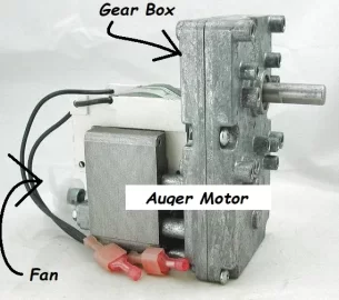

That puts me in mind of the cooling fan on the auger drive motor which has a flat gear box on it. Below is a Harmon Auger motor & drive gear box, mine is just an upside down version with black fan.
I know that the older Harman auger drive motors had these cute little cooling fans but thought they had done away with those in recent years.
