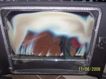

I am still trying to figure out the best settings on my stove , but have a question for everyone. After a week of burning how full is your ash pan? Does everyone get as lot of ash in the bottom of the stove that is not in the ash pan like I do? Last of all, after 3 days of burning I have a rainbow shape of very dirty ash/soot on the top of my glass, and smears coming up from the bottom where the air blows up the glass. Does everyone elses stove glass get that dirty so quick? - Thanks

I get ash in bottom of stove, not in pan as well. I would think that is normal. I used to get exactly what you describe on glass, rainbow shaped very dirty, black sections on glass as well as smears coming up from bottom. I found that my OAK intake pipe was not connected to the intake port on stove. Once I re established fresh intake air, no more dirty glass. Hope that helps.
ON EDIT: This doesnt mean to imply that my glass stays 100% clean, it still gets dirty, but takes much longer to get dirty. Lets face it, theres lots going on in there, I dont think anyones glass would stay pristine.

I get very little ash outside the pan. After burning for about a week, I have about 1 inch in the ash pan, probably mostly from what I scoop away from the burn pot (twice per day). The rainbow pattern shows up on my glass too, but always very light, in color and density. Every time I fill the hopper, I brush the accumulated ash from the burn pot and very lightly swipe the inside glass with a cotton towel. It keeps the glass fairly clean, but towards the end of the week, the top of the rainbow becomes more stubborn, requiring a cool down and a shot of glass cleaner, at that time I'm scraping the burn pot, vacuuming, and emptying the ashes anyway.

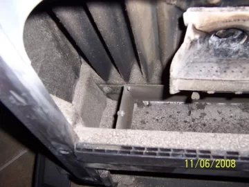

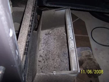

Here are some pics of my stove after 3 days of burning, does this look normal? Accidentally scraped the burn pot before I took the pics.
That pattern of soot looks very familiar ;-)
