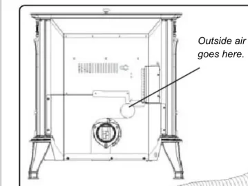

Do you have an outside air kit installed?
Washed-Up
Nov 5, 2011
1,074
Kananaskis,Alberta, Canada
ok it’ll be a bit easier for you to check the flapper on the air intake to make sure it’s moving freely, if it’s not, just lube it with 3in1 oil and move it through the full range of motion
