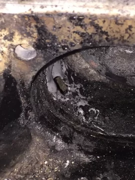

I have a Harman XXV, about 7 years old. When cleaning it lately I noticed a hole between the auger and burn pot. A local welder won't fix it (liability) issue and I am not able to repair it myself. My local dealer suggested JB weld, which I did, but now I'm afraid to run it. The first round of JB weld fell through the hole and the second application seems pretty thin.
Is this beyond repair? I am not opposed to replacing it. This stove has been an igniter hog. Any suggestions on a replacement. It is less than 1000 sq ft space.
Post a picture or two so we may get a better idea. Several of the firepot components are replaceable.

Ooops. The pic must not have attached.

I see why you might have a hole that far back, a 50,000 BTU stove heating that area( 1000sq ft) the fire probably is concentrated there quite a bit. What exactly is the hole in though ? I suspect that replacing the stove is going to be costly compared to repairing yours. What stove might you have in mind ?

Our dealer thinks it would pretty costly to take it apart to get to the part. The hole is just in front of the auger and before the pellets fall into the burn pot. We originally bought the stove with the hopes that the heat would rise and also warm the upstairs a bit. It did to a point. I'm looking at a smaller unit. I've seen some conversations on the forum about a few models. I'll look into them.

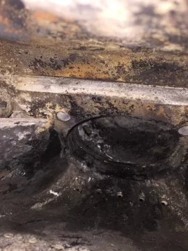

Not sure what I'm looking at in that picture, I guess the hole is in the auger tube assembly ?
Yes. Maybe this photo will you a better perspective.

It looks to me like the feeder body would need to be replaced. I'm no expert but this looks like the part you would need:

Maybe pull the firepot off along with removing auger to gain access to auger tube. Clean area and try patching in from beneath tube with same radius sliced tubing and weld from within tube. Doubt brazing in hole will hold up to heat.
I thought this was isolated to burn pots with those 5 holes directly in front of auger hole. After seeing a couple of PC-45 units with this problem I'm not convinced since they don't use that type of firepot.
Inclined to think its more of an auger tip breaking off issue which allows for more fire inside the tube and metal erosion.
My pc45 is torn down to bits right now as i pulled the whole auger feeder assembly out to weld it. Regret doing that now because of the amount of labor, and can't imagine doing that on a cast iron XXV.

That's a replaceable part called the feeder weldment. I did it on my Harman Invincible RS last year.

At the bottom of the burn pot ( near auger tip) are there five holes running the width of the burn pot? If so, it is possible that it would be covered under warranty(parts and labor). I have replaced a few for owners of XXV, and Accentra FS. Check with the dealer and have them check with Harman.
Reactions: TStark
Thanks for all of the help on this. I never about warranty coverage. I talked to a Harman dealer yesterday. Best case: feeder tube at 250 + labor. Worst: entire feeder at 1200 + labor. They won't know until they get it torn apart. Big job either way and certainly nothing I am capable of doing. I am really torn about what to do: on the one hand, the XXV is more stove than we need, but I can have it repaired for about less than half the cost of a smaller unit, e.g. P43 or Piazzetta. A couple of places around here are running sales. On the other hand, it would be nice to have a quieter and perhaps more efficient stove.
