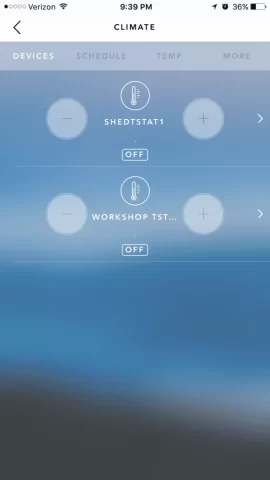

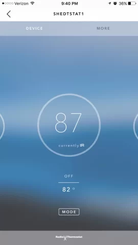

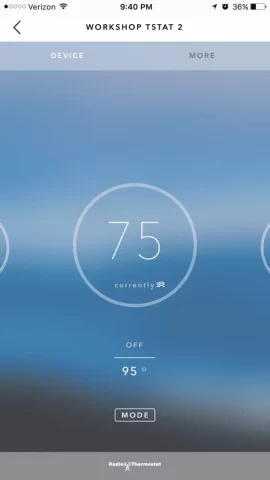

You can also get a wired T-Stat with a swing setting for pellet stoves, Wireless SkyTec T-Stat or Lowe's Iris WiFi T-Stat for your smart phone like I have.
Below is a pic of my iPhone T-Stats for my Quadrafire & Harman pellet stoves in the shed & workshop.
A little too warm to turn them on right now! LOL
