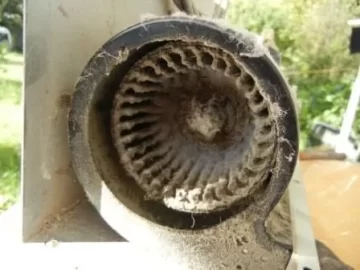

Outside of any warranty! Ever remove and clean? Can accumulate a lot of dust bunnies. [Hearth.com] Harmon blower noise
Never removed it altogether. Is it pretty simple to remove on a P68?
P series Harman stoves are known for ease of maintenance. Remove rear shields after unplugging stove, only couple bolts holding fan assembly to back of stove. Unplug the power leads. Others can jump in help with other things that should be tended to also.(fines box etc)
They are easy to remove. Mine was TOAST. When I got it apart the fan would not spin easy at all. And it did need to be cleaned as well. Another thing to clean after burning a ton of pellets.
