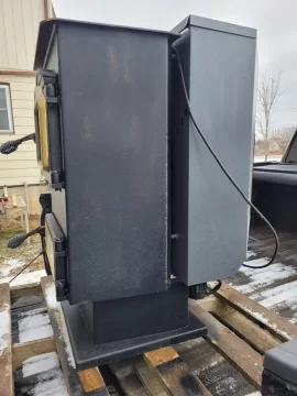

Ok managed to get some photos of the stove. Once I opened the ash tray compartment and cleaned out the massive mouse nest I found 2 of the fire bricks and 2 metal kind of triangle shaped metal pieces? Not sure where they go. I see that it needs a good clean out and vacuuming before i put hydro to see what fans , motors etc work and what Doesn't! The ash tray seems fairly sturdy still will know better after a good scrape and brush out. Should I paint it with BBQ paint or leave it natural?

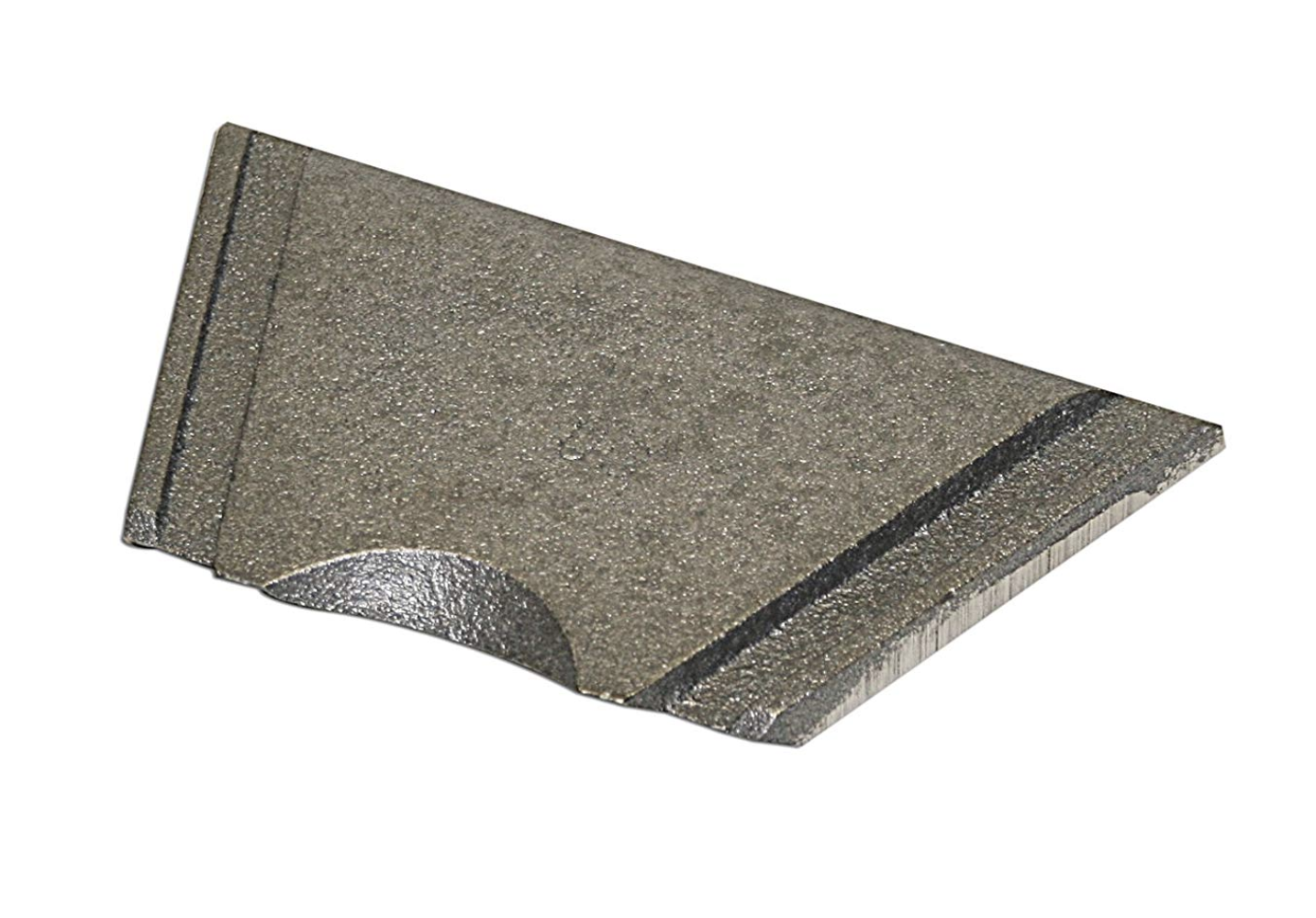

Well, that’s a pellet pro 2, in decent shape I’d say. The 2 pieces you found in the firebox should actually be one piece, it’s the flame guide for the burn pot. With a bit of cleaning and a part or 2 hop
you’ll have great heat out of that.
Thanks, upon further inspection today doing pictures, I came to realize that they gave her a squirt of flat black paint to clean it up on the outside but other than a good clean and blow out will see how electronics work. Thanks for the link to the manual as well, I’ll follow the directions for yearly service etc and see how it goes. Should I see if I can get the broken pieces welded, or order new ones? Or can they go back into place without much malfunction the way they are.
