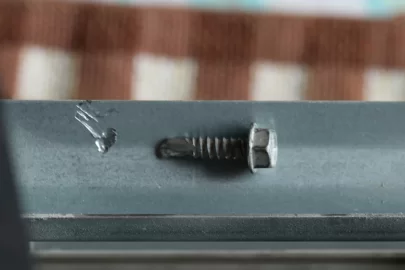

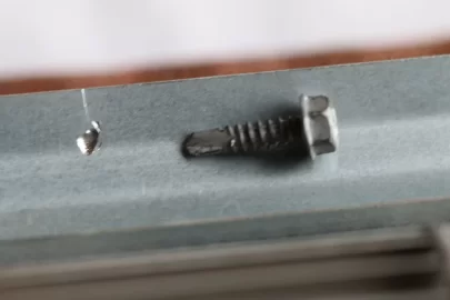

Had my Son take out the blower other day. We ran it outside the stove today. No Noise, but I noticed 2 spots where screws that were coming thru impacting the fan case. Fan is being reinstalled right now. Will follow up with what happens. But it seems the loud buzzing is metal to metal contact thru poor assembly.

It buzzed last night on the sheet metal behind the Auger Cleanout. Putting block against it stops it. I pulled block and set the fan back to Medium and no buzzing all night. It seems (Cross your fingers) to be fixed.
