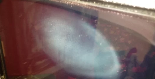

While we're on the topic of XXV glass, anyone experienced a permanent glass cloudiness? Possibly an issue with the glass coating? I have an oval shaped cloudiness dead-center top of the glass. It will not come off no matter how much I scrub on it. When I rub my hand over it, it feels as if there's an issue with the coating maybe. It doesn't hurt the viewing of the flame, more just annoying when I clean the glass. Any ideas? I've included a picture.
Note: The flash from my phone accentuates the cloudiness. It doesn't look this bad to the naked eye.

I have one though not as big and nowhere as cloudy...mine is barely noticable when the window has been cleaned.

I had the same cloudiness as the other poster until I purchased Rutlin glass conditioning cleaner. Rub some on when the glass is cold and buff it out.

Thanks twodogs02, I'll have to try the glass conditioner. I've pulling ash down but I think the cloudiness was already on there when I got the stove. Bought a showroom model they were replacing for an enamel color coated one. Love the stove, works flawlessly otherwise besides the glass cloudiness.

That is how my St. Croix is. I bought it used and it came that way. Everything around it is smooth and cleans up fine, that area has a slight texture and I've tried a couple different types of stove glass cleaner without any affect.
