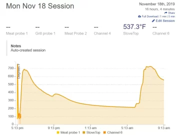

Here's a post I recently made after I messed around with a 20 hour log and then another few hour one.
So I used a different probe setup on the stove top and really changed the effective range of it so it could measure accurately in the progression of usable heat. Which means it will not accurately read below 225*F. I have not yet pushed the stove past 800*F (And honestly, I really don't want to again), but I have verified with an IR temp gun that the reading I'm getting from my probe is accurate... Here is a screenshot of the data I've compiled from my first run with my Fireboard. Throw out the first 20 minutes or so as I was experimenting with converting a K-Type Thermoprobe to an RTD type. (Heads up that did not work)
Also this shows that I loaded the stove around 5:30PM with a 1/2 full firebox, and just let it go till it went out. (It was a bit warm over night so I didnt want to run the stove) You can also see a peak around 6:30 and then a quick dip down... That was when the fan set on low kicked on... Then you can see I loaded up this morning and it peaked around 738*F.
