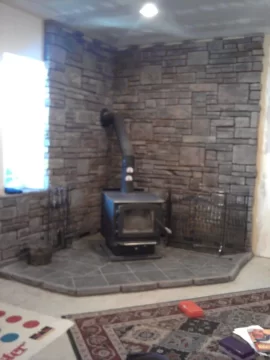

We installed the NC30 to see how it would perform n our home. The install went beautifully and will have to post pictures. It does pretty good, but we ask it to do a LOT!! I am thinking about moving into a different stove... BKK, Equinox, Progressive Hybrid or PE T6 unless there are other suggestions.
The Englander does OK, but we go through a LOT of wood. We are heating almost 6000 SQ ft, but are very well insulated. So my goal is to go to the biggest most efficient stove. The only problem is that we have 6" pipe that was installed. To change it is a MAJOR deal for us because our home is concrete walls. So if I go with either of the first 2 stoves I have to step the pipe down to 6" at the stove. BTW, the central heat really only comes on about 1 time in the early morning with the set up we have now. So I know we are pretty close.
