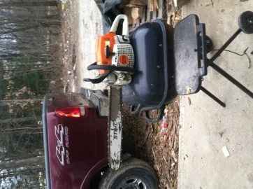

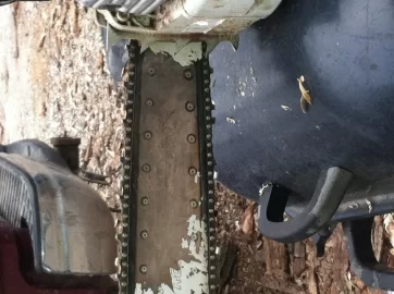

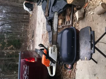

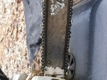

As promised here are some pics[Hearth.com] Having trouble with Stihl customer service[Hearth.com] Having trouble with Stihl customer service [Hearth.com] Having trouble with Stihl customer service[Hearth.com] Having trouble with Stihl customer service

Anyway seems like a lot of wear on something I just bought 6 wld ago. Cut 9 Rick with it

Looks like a 20" bar, right? That's the max "recommended" bar length for that saw. Those ratings are more selling points than practical limitations. In hardwoods, I wouldn't go that long on a 50cc saw.
From the wear pattern on your bar, it looks like you bite in with your dogs and lever down into the wood a lot. If so, you could be creating a lot of extra friction (heat) that can't be handled by the B&C oil. Try letting the sharp chain cut the wood without leaning on it.
Another test is to have the dealer swap a known to be functioning 16" bar & chain (or 18") onto the saw to see how it throws oil. If the dealer doesn't have one of those around, leave the store and find a good full service dealer.

Lol you're rite joful 290 s aren't old and a very good saw to boot. Ill take that under advise tree pointer i really don't bear down on my saw, it cuts very well just seems to get hot real quick compared to my others. Ill talk to the dealer tommorrow and maybe buy an 18" b&c for it. Most of the larger rounds I cut are 16-18" max anyway. Mostly tops from where the forestry has been logged
