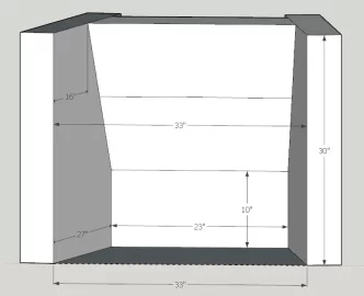

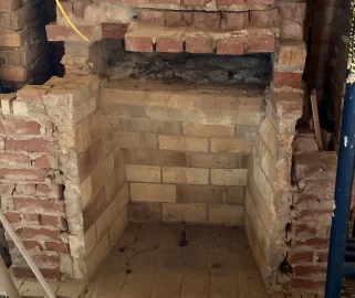

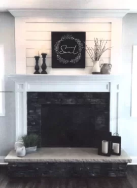

The existing fireplace was presumably built in 1928 when the original house was built. The prior owner did a substantial amount of demolition work removing all interior sheetrock, electrical, plumbing, etc. Evidently, as you can see in the attached picture, a substantial amount of brick was also removed during the demolition. The mason I am working with does not believe there was ever a damper installed on the original fireplace. This is a problem since we are wanting to control (or minimize) any air infiltration so we have secured a cast iron replacement damper from Vestal to be installed by the mason as well as some steel lintels. In looking up through the chimney, there is absolutely zero evidence of soot. There is a double chimney above the smoke shelf. Attached is a picture of our objective for this fireplace. We want to raise the forehearth a minimum of 6" and a maximum of 8". Since the firebox floor and hearth are currently the same height, we will need to raise the firebox height appropriately. In looking at inserts, we could not readily find an available one that would fit in the fireplace box, albeit our search was last year, and supplies may have changed. I believe our opening after modifications will be 24" x 33", or 22" x 33" depending on high we raise the forehearth. Thanks in advance for any comments, suggestions, or answers.

Do what makes you happy, but that objective photo would look a lot better if it were not a raised hearth, but rather flush to the floor.
Chimney cross-sectional requirement is indeed calculated on opening, with the usual problem being too little chimney cross section for a given opening. There's some range in the recommendations, so it's entirely possible the opening could be reduced without requiring a completely new chimney.
Anything you do now can be undone, it's only a question of effort and cost. The fireplace behind me had an original opening of 30 square feet, reduced about 120 years ago to something less than 15 sq. ft., then framed in and converted to a gas insert in the 1990's, before being fully gutted by me and opened back up to it's 1775 configuration. Anything is possible, so unless you're concerned with preserving historic construction, I'd not let potential future owners' desires influence your decision.

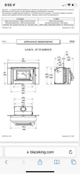

The picture you showed looked like averageish depth and slant. How about a Blaze King princess insert. It’s shallow. So it really sounds like you have lots of options. With the concrete slab under it all
Thank you for your reply. Allow this is not quite the look we are attempting to achieve, but it does show that there are options. In looking at the manual and dimensions, it appears that I would have to position the insert quite a bit forward (away from the back of the current back of the hearth) in order to properly vent the insert through the chimney and clear the smoke shelf. This is counterproductive for our application as we are trying to work with the current footprint of the hearth and not extend the forehearth any further into the room while raising the level of the firebox floor... which pushes the insert further into the room.
