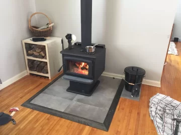

Just wanted to share my hearth pad install if you're looking for other ideas.
I laid one piece of cement board directly on the hardwood, with porcelain tile (bought on clearance) floating on top. No grout or mortar, and just butt the tile against each other. I shaped the trim pieces from 2x4s and stained them. Routed out the top edge to slide over the tile, and then threw a couple trim screws through them into the floor to "lock" it all down. Tile doesn't shift st all, looks nice and I only put about $70 (Canadian) into it.
If you're interested I can post a picture of the profile of the trim I built. It was easy to do. One pass with a router to cut the groove that slides over the tile, and one cut on the table saw to cut the slope.
Good luck with your own hearth install.

That’s pretty clean too. Did you have any trouble getting it WETT certified? Is the cement board considered a non combustible material?

I really like the look of this . . . looks sharp and quite clean looking.
Firefighter jake: thanks very much. Happy with how it turned out.
Sg566: I had the stove professionally installed and I think you're correct; the cement board is the ember protection. The tile doesn't technically count because it's not one continuous surface (no grout). But no WETT certification issues.
