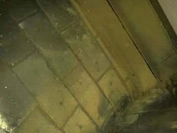

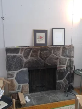

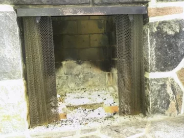

What is meant by a hearth fireplace? Is this an entirely masonry constructed fireplace or something like a heatform with a metal shell inside of a masonry jacket? Pictures may help.
It is a masonry chimney. The front stone you see is just a fascia built in front of the brick chimney which is sitting on a large concrete pad built into the foundation of the house. The inside of the fireplace has apparent masonry as well. The only steel in there is the register plate and the steel angles to allow for the fireplace opening.

If this is a full masonry fireplace then alcove rules don't apply. The concern is mantle clearances but that's not an issue in this manteless installation. The stove will still need 16" of hearth protection in front of it. In the manual Morso recommends:
When the stove is positioned near non-combustible materials, a gap of 4 inches or more is recommended for cleaning purposes and to ensure that heat circulates around the stove and out into the room.
There should be a full, insulated stainless liner on the stove and ablock-off plate below the damper area
