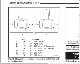

I have a VC Enore 2550 running 24/7. Its on the edge of my fireplace hearth which is raised 2" above hardwood flooring.
I am building a 18" hearth extender and have read everything I can but can't figure out whether I need type I (ember protection) or Type 2 (heat protection).
Anyone have a quick answer?
