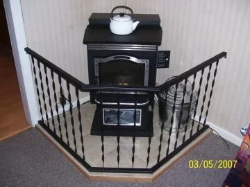

I helped a buddy of mine build a hearth. We used a old sheet of 1/4" diamond plate, wrapped the edge with 1/2" rod iron and painted it flat black. Made a nice hearth. I like it better than my tile hearth. this is my PC45 notice the baby guard I made to keep my baby away

That looks real good!
I like the rod iron and kettle. Will have to get our kettle out of storage.
Good to put moisture into the air.

Can you remove it easily to do maintenance ect?
The top rail is like channel iron upside down and it straddles two l brackets attached to the walls
