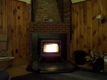

Thanks for the replies. I should have included more details and a picture. In the picture below, the twisted chimney will be framed and covered with sheetrock over the next 2 weeks. The brick mantel (no overhang) will be ~12 inches deep. I'm thinking that the top of the stove to the bottom of the TV would be around 3 ft distance in height, so a bit more than when calculating the diagonal. The ceiling fan in the room, which is pretty close to the stove, will run 24/7.

So the tv, if we decide it is safe to install up there, will be a bit above that pot on the mantel.

that looks like a Hearthstone Homestead, right?
the surface temps are lower than with plate or cast stoves, so thats in your favor, but the unit has no blower option to decrease heat off the top.
depending on install config 36" might be required from top of unit to a mantel, or combustible trim, but those codes are written for fire saftey, not tv saftey. niether tv nor stove makers want the responsibility of coming up with " safe" parameters for a reason!
