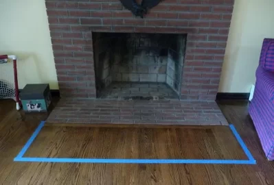

Anyway, here's the sad, stoveless state of my fireplace now. Blue tape represents about a doubling of the hearth depth to ~40".

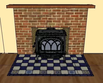

And here's what I'm hoping to see by Thanksgiving. The Oslo itself was a free model in Sketchup's online model database (they also have the Castine, the F3 and others), which goes a loooong way in helping me visualize it, don't you think?. I had to create the tiles as custom components - they're 6x6 tiles with a 2x6 border. Accent tiles are just for the concept.

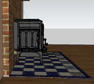

Now for my question for Oslo owners - how far forward of the wall does the stove need to be for me to open the side door wide enough for loading? As it is drawn above & below, I have about 1" more I can go forward and still meet the 18" clearance requirement, and the rear legs are just about flush with the masonry. Will this suffice, or am I going to curse the side door handle every time I bump it up against the brick and wish I had put another row of tile in?
