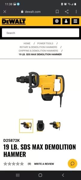

My guess is chipping the concrete down to or below subfloor level won't be too hard....often those slabs do not pose much of a problem and are often above the subfloor. A 15lb demolition hammer with a point and chisel should do the trick and shouldn't be very dusty in the grand scheme of things...wear safety glasses.

That should work too......I would suggest having a helper that is holding the hose of a shop vac very close to the grinder as you cut to help with the horrendous amounts of dust the grinder will create.
If your ok with the dust in the house then go for it.......if not, I suggest renting a demo hammer from anywhere that is close to you. Lowes,HD, or similiar will all have one for a fairly minimal cost.
