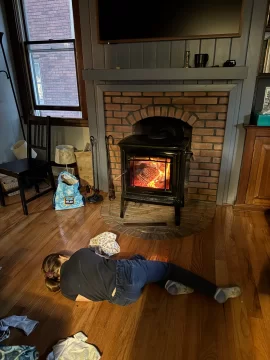

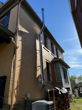

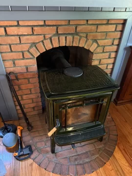

I'm a new Craftsbury owner looking for any advice from seasoned geeks out there. We've installed a new Craftsbury in the living room of our three-story, 1600 sq-ft, 1918 house in Pittsburgh. The stove sits just in front of the original fireplace area that was originally used for coal or gas. We demo'd the decrepit masonry chimney to the roofline and blocked the rest ;emand punched a hole through the wall to run a couple feet of stove pipe from the rear exit out to a 90-degree chimney base, and then about 21 feet of exterior chimney. All Selkirk Supervent 6" installed to code. We're hoping to So far I'm happy with the install and draft and just have some fine-tuning questions.

The picture of your fire looks good! Glass is clean and I bet it's throwing off some good heat. You may want to look into a digital wired probe style flue thermometer as you won't be able to use the traditional dial style going into that chimney. I put a flue thermometer in before this burning season and I wish I'd done it earlier.
I have maybe 5 ft of double wall chimney pipe going into maybe 24ft of Class A outside. So my situation doesn't look too different from yours aside from mine being a top exhaust. If I load the stove full it will run away easily. I find it difficult to bank coals and get a slow traveling burn with the shape and size of the firebox. Perhaps with slightly more dense, dry wood and larger splits you'll have more luck.
