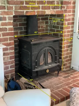

We are looking at upgrading from the Federal Airtight (XL?) that was built into our 1987 home with an original installation that is a little limiting.
We are looking at the Progress Hybrid, but are happy to consider other suggestions. I am attaching a picture with some measurements of the current installation, and wonder if anyone could help us imagine a PH installed in the same space. The PH seems to be about 1" wider and taller, and maybe 2"-3" deeper.
Of concern are the loading door, which on ours does not open all the way but is sufficient to load - I would like to figure out how far forward the front of the PH would be to allow similar. Also, the ash pan would appear nearly impossible to extract if the PH is set back similarly to our current stove. I was thinking about getting or welding three pans to replace the single pan (!).

The Progress is a side loader and the side clearance on the door side is 16". The front hearth requirement with regular legs is 12". This can be reduced to 8" with the optional ash lip. For these reasons, a front loading stove would work out better.
A possible option would be either the Hearthstone Green Mountain 80, or the Manchester. The caveat is the alcove. Modern stoves have tighter regs for alcoves so regardless of choice, be sure to verify that the alcove where the CDW stove is located passes muster with the manufacturer. Give their tech support a call to verify.

My wife does not want it to come forward too much, and side load is better for peace of mind and mess. Again, our side door does not open fully, maybe 70 degrees?, but it is enough to load the box. I would like to know or calculate how far the stove could sit back in the alcove and allow the side door to open that far.

Send that picture to Woodstock and they should be able to give you a good idea if the PH would fit. With a front loader stove you will need 16” clearance out front so most likely you will need a hearth extension. May or may not need to extend with a Woodstock side loader?
I have the Fireview and it doesn’t have an ash pan. I just shovel the ash out carefully into a container next to the door. If your draft is good the fly ash will get sucked back into the stove through the door.

The Manchester can side load but again, alcove requirements have changed. Check with the mfg. first.
It looks like a pretty deep hearth at 50". A 25" deep stove would still have 25" of hearth in front.
well isn’t the draft adjustment on the back of the progress as well? That would be annoying to me reaching in like that unless you can bring it out far enough to access it and see the draft level. My vote would probably be a pe summit/t6 or could go for one of the kumas which seems to work very well and push out the heat. Or if you can get one the Woodstock ideal steel would work as I think all the adjustments are on the front but no fan option.
Also I was just thinking if that’s an alcove and not a fireplace depending on how it’s built you may technically have to pull the stove all the way out to meet the clearance requirements off the top of the stove, but I could be incorrect maybe someone else with a bit more knowledge can provide insight.
