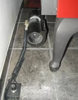

I bought a fan blower and placed it on the floor below the back of the wood stove facing up. Not a stove model to the stove buy works just as well and my cost was $99. on ebay.
  • [Hearth.com] Hearthstone Heritage. Does a blower increase efficiency?

Spike, is that a dime under the leg of your stove? LOL, if so I did the same thing on my stove to level it out since the ceramic tile is textured. Great minds think alike.
-Kevin
Sorry , no dime here. The legs of the Pacific Energy stoves ahd adjustable feet / bolts that adjust up and down to level the stove ........... must be the end of the foot / bolt you are seeing.
Search Ebay for "heat glo fan" and also "heat glo blower" , there are some good deals on there for around $99. .
Thanks for the tip Spike. I inquired about the leveling kit for the Country stove I have and it was $15 bucks for some special washers and machine bolts. I only had one leg I needed to shim and a dime fit perfectly under it and is unseen, so I opted not to purchase the kit. So far it hasn't melted or walked away ;)
