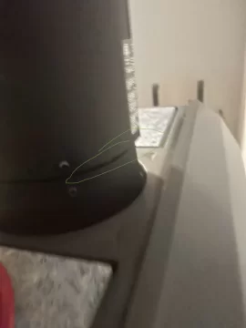

I have the hearthstone heritage. Really like the stove a lot. Just wondering if anyone else has a really high draft situation. The control to shut it down doesn’t do a lot. It does some but not enough so that I ever have coals in the morning even if I pile it with hardwood. I have a straight double wall pipe that is about 25ft. I have tried a damper key on my last stove which didn’t do anything. I checked for air leakage. The only thing I found is that air sucks up the pipe at the base a bit. Seems to be attached well. I’ll send a pic. The people who installed it told me that it’s not air tight there. Anyway is there any way to slow the draft down. They suggested two damper keys but that seems crazy. I can live with it how it is. I have got used to it and shut it down quick but there must be something.

I don't think a little seepage at that joint is doing it, it would less lessen the amount of air through the stove by pulling through the crack.

I had a stove pipe damper on the last stove and it didn’t make any change at all. I could try it again with this new stove. This is a pic of the draft turned all the way down. It’s not like it’s out of control or anything but I never have coals in the morning and the wood burns fast even if it’s hardwood. I wish the control on the stove could be closed even more. I also found the first year I had the stove I was able to get it to burn slower. I vacuum out the cats when they look dirty and that seems to help. I find when they are dirty it gets insanely out of control.
