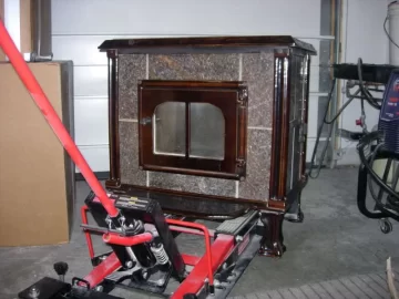

Hi - can someone talk with me a bit about the pros and cons of the Hearthstone vs. something like a Vermont Castings? The particular stove I'm looking at is older, a Hearthstone II. According to the owner it's been used only about 20 times and now they want to sell it. I believe it was manufactured/tested in 1981, which is a little bit of a conern, but maybe shouldn't be. A picture of the stove is attached. They said it was $3000 new are are asking $1500.

wow, looks to be in excellent condition... if the inside looks anything like the outside (from the pic), then that explains the price tag.

it also weighs close to 600 lbs if i remember. there is a reason its on a floor jack. i've moved plenty of stoves and that one was the scariest!

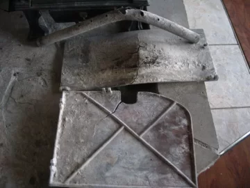

:-) found this in one of my albums... Hope the one you found is in better condition :-) . kw, that secondary tube... a $10 length of stainless with a few holes drilled does the trick ;-)

burning chunk - that's exactly what i did for the air tube on the one i did. i went to a metal dealer and they had tons of odds and ends to choose from and got a really nice piece of stainless for about $15-20. came out better than the real thing.

I replaced all metal parts inside the stove that way... rebuilt the entire thing for under $100 :coolsmile: re-cemented the stone and the stove is good for another 20+ years :-)
