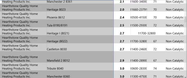

If you look at the EPA ratings, you see that high output on the 8360 is much higher than on the 8361 Manchester 2. I don't know, maybe they throttled back the air or something, because it was too easy to overfire the 8360? I think they might have had both models in the shop but I didn't look closely to see if there was an obvious difference...
I stopped by that stove shop again today; Yes, they had both an 8360 and 8361. They had the small metal EPA tags, the 8360 is 3.0 g/hr, the 8631 is 2.1...just missed the 2020 limit of 2.0. :( Looking closer at both of them, the difference I saw was that the 8361 has a row of holes through the back of the air wash casting, letting some air go to the area of the front-most air tube. There was a 1/2" tall strip of sheet metal on the fresh-air side of the air wash casting, long enough to somewhat block those holes. If they are supplying additional oxygen in the area of the front tube, it may be burning the smoke more completely and getting the stove down to the 2.1 g/hr. That would be an easy way for them to clean up the burn without major re-tooling of the stove. There would also be less air shooting down the glass and supplying the primary fire on the wood. That could be why the 8360 got more BTU/hr. at the high-burn rate in the EPA tests. With them tapping off some of the air wash air and the fire on the wood presumably less, the glass possibly wouldn't stay as clean, but that's probably a non-issue.
Interesting. I’ve got the 8360.
Never knew about the heat output difference.
[Hearth.com] Hearthstone Manchester
Here's the complete EPA list, bottom link on the page: (broken link removed to https://www.epa.gov/compliance/list-epa-certified-wood-stoves)
