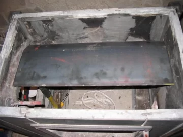

yes, I had two of the stones split in half (you could see the flames through the crack :roll: ). After talking to Jim at Hearthstone, I cemented the entire stove, stone joints/corners and all cracks. You want to squeeze as much of the cement INTO the crack as possible, from inside and out, but clean the excess on the outside. Then you "parge" the inside around the crack.
here's a pic of what it looked like after cementing. Left back corner stone had a small crack forming, the right side stones were the ones cracked in halves.
You are correct, there are no firebricks, steel and stone only.

This is an OLD Mansfield! Without the secondary air tubes and the air wash door. You're lucky in that aspect as it made your repair simpler. I have to replace the primary air manifold on mine. I'm waiting on the parts and the instructions. How'd you get your top off...by unbolting the rod that runs up the corners?
Chris
