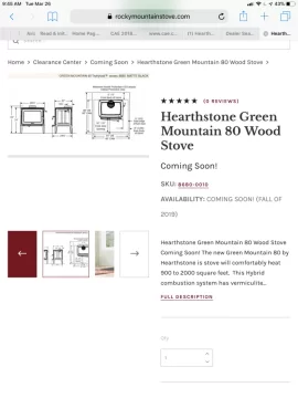

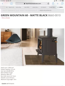

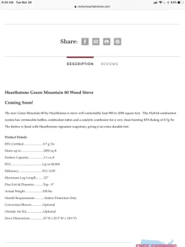

E7F472ED-E529-44D3-B170-D428E586788E.png 4A526491-3B50-49A9-99B2-F37462C56921.png 0E2E9299-7558-45C5-B2DF-6DDF2CEA2867.png
So I’m wondering if anyone on this site has gone and bought a Greenmountain stove that can give some user experience. If not then I will ask the dealer if I can speak with someone who has purchased from them.
They had a 60 on the floor yesterday and I looked it over. It’s a heavy cast iron stove and is lined with soapstone rather than firebrick on the inside. Here are secondary burner tubes with air control lever plus a small cat with temp probe and operating lever. It’s not a soapstone stove like their other traditional stoves. He was showing it to me because of the burn time and efficiency they say you will get out of it that I would burn less wood than a T6 with less fill ups and longer burns but still get the same amount of heat out of it.
