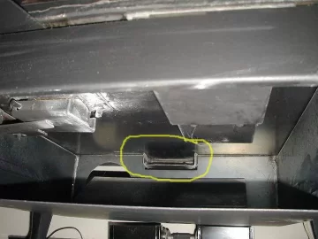

With all the talk on another thread about run away fires in stoves with secondary burn tubes does anyone know where a Hearthstone Homestead pulls it's secondary air at. I was wondering if it was accessible if you could cover it to starve the stove of all air.
Some where at the bottom back would be the norm.
Pictured below is stove brand X showing the secondary air inlet.
This is the bottom of the stove with the ash pan out.

looks very similar to stove brand Y that I just ordered. ;-P
