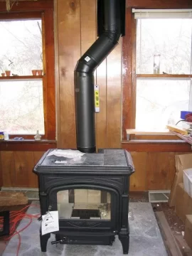

the chimney is a total of 12 feet, and it is 6 inch pipe, I am attaching a picture of the installed stove ( just after they installed it)
please excuse the mess in my studio as the chimney installer was not totally finished.
as you can see there are two 45 degree angles in the pipe, because there is a steel I beam straight about the stove. ( this was the only place we had enough floor support and wall space without being in front of a window)
the chimney outside is a double solid insulated pipe with a small cap and a spark screen, I can't get on the roof to get a picture of it.
from my bill of sale for the chimney, the outside sections are 48 inches and 24 inches however I do know that part of one of those sections goes through the cathedral box. ( I think it is the 24 inch part)

the owners manual says that the stovepipe should be as short and straight as possible, and that the larger the number of elbows the greater the chance for draft resistance.
I have three 45 degree elbows
one is not visible in the picture as it is in the base of the bottom stovepipe into the stove.

Onward - At least this stove has a straight up chimney - this helps! And...the 45 degree elbows are much better than steeper ones.
Here's the deal with chimneys - I have had a number of straight up chimneys of 12 feet work well, so even though that chimney is a little short, I would not assume a fault on the installer...as long as the chimney height meets the code of distance above the roof...
Bottom line: Add a 3 or 4 foot section to the chimney - support it with the kit that the manufacturer sells.

I have read enough Frank is right its a draft problem and the dealer who installed it. sucks
Every 45 degree ebow produces enough friction to reduce the length by 2.5 ft Let me explain this the glass half full or half enpty
Ideal minium straight verticle length is 13 ' Somke travels ina circular pattern as it assends ech circular path it gains momentum
It is obstructed by a elbow and looses momentum., To re gain the momentum one has to straight verticle length/. In your case code each 45 degree elbow one has to add 2.5' to the verticle length times 3= 7.5' plus the one shorted you need about 8' more feet. Another way draft can be inscrease is to keep heat in the pipe your single wall connector pipe would loose heat if it were double wall to the stare of the chimney. . Dealer double taulk he is lying what Frank says.
Here is where a good inspector helps get things resolved. Go down to your building dept talk to the inspector. Tell how your stove will not draft correctly and bring down your manual. Tell him according to the manufactures listing and specs the chimney was improperly installed.
It does not meet the correct verticle length and tell him there are 3 elbows in the run. Every thing I have said here is standard code concerning elbows. Pull the permit and have him fail the inspection. Them call the dealer and tell him to install a code compliant chimney. If he has any questions direct them to the inspector. Let him argue code with the inspector. As an inspector it is easy to fail an installation when the faults are already pointed out in advance. The installer is practiced in BSing un supection owners. It's another thing trying to BS an informed inspector. If I were the inspector, I would now be wondering how many other bad installs this guy made in my town. I also would be making a mental note that this guy bears watching. If he trys to BS me I might request his records of all the installs he has made in my town the past 5 years. You know where this going and it is not going to be pretty for the installer. I have all kinds od recourses like tripple fees. If he has an ounce of intelligence, he goes back to your install and makes it right

I sent the tech at the manufactures the article from here about the elbows taking away effective height, and he asked me to email it to him which I did.
also a picture of the install.
the store says that the 45 degree elbow at the back of the stove to connect to the pipe 'isn't even an issue' as per the store manager. She also was the one that got snippy with me...

I agree with the consensus that the chimney is too short. When a manufacturer says 13' MINIMUM, that means in ideal atmospheric conditions with minimum exposure to outside temperatures and no elbows in the pipe. Like Craig, we've had installations draft just fine with short chimneys, but not always, and not often when so many things are present that adversely affect draft.
This installation has three 45's, a short chimney, and a soapstone stove at the bottom. From the photo, it looks like nothing can be done about the 45's due to rear clearance requirements, but the chimney should certainly be extended 3 or 4 feet (make sure to add a roof brace).
The Phoenix is also a factor here, not because of poor design but because it is made of soapstone. Soapstone stoves soak up much of the heat from a newly-laid fire, which results in cooler chimney temperatures and sluggish draft until everything heats up. Firing a cold soapstone stove is a different process than with a plate steel or cast iron stove: you can read more about getting a soapstone stove going at (broken link removed to http://www.chimneysweeponline.com/hosoapstone.htm) .
As to opening the ash drawer to provide an easier flow of intake air at startup, we recommend it. The manufacturer doesn't want this door left open once the fire is burning briskly, as that could burn out ash grates, but a little common-sense operation can really help in getting a cold soapstone stove going.
