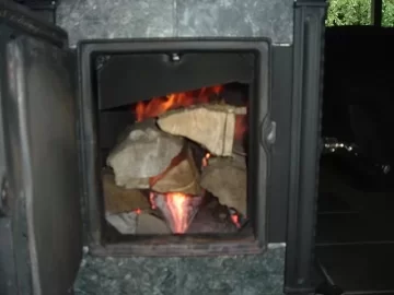

You know I mentioned the other day I did well by adding some more small splits - sticking with my usual 3 @ each load interval plus one or two at random ain't gonna do it - I need to make a run at 6 of them now that I've clearly defined what 3 or 4 will do for me. the learning process continues...
Here you go Ed. Loaded for bear with 7 splits plus coals. You can't do that unless your ash heap is down. This was one of those times when the "F-around gauge" was down to zero.
