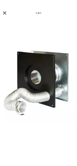

Our pellet stove has a pipe straight out the back that I believe is an exhaust pipe, and the intake is just behind the ash bin. Any idea how OAKs work with p68s and if it is of any use in an old, drafty house?
If you don’t have an “O.A.K.” you are pulling in air that you already paid to heat, and exhausting that same air...An Outside Air Kit will pull air into your stove for the combustion burn, from outside your home, and exhaust that same air, saving the positive pressure that your house hopefully has. Ive attached a diagram of where your air intake port is, if you want to add an OAK, you’ll need a 2.5-2.75” piping kit to go through the wall or the thimble to pull in outside air. On my stove I used a hole saw and cut a 3” hole next to the exhaust in my wall thimble and attached a 3”pipe to a flex hose to the 2.75 air intake on my stove a P61A the next Harman down from yours.

Now you've done it! Which is better - Ford or Chevy? There have been numerous (sometimes heated - see what I did there?) discussions on whether and OAK is beneficial or not. I have one, and my stove is on the windward side of the house, and we get a lot of wind up here. The stove is unaffected by the wind, due to the OAK, whereas without it, the wind would surely try to create back pressure in the exhaust. It also helps if the power fails, since the smoke blows very little into the house. The stove is also unaffected by any exhaust fans running in the house, also. If your house is really drafty, an OAK may not make much difference, but I can't see using air that you've heated for the combustion process.
First time I've ever seen a FAK (OAK) on here, FAK (Fresh air kit to me) installed through a wall thimble. Not a bad idea actually. Mine is separate and has it's own outside screened cover to keep rodents out.
