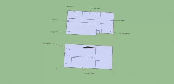

I'm setting up my space heaters today and get it cranked up down there to run another test. Here is a sketch of how my upstairs and basement is. The pellet stove is currently located in the far end of the living room, and coal stove is to be located in the utility room in the basement. There is a set of double doors at the bottom of the stairs that goes into the spare room, another door that goes into the utility room. The walls are only half inch drywall with no insulation, so the heat should distribute into the rooms easily. The heat apparently rose up through the drop ceiling and into the bedrooms when I ran my test, and went up the stairs into the kitchen, the coolest room was actually the living room upstairs when I ran my last test.

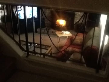

I run my pellet stove from the basement, and it works quite well. I have employed my furnace's blower in the air distribution of the pellet stove, and it works quite well - I put a cold air return right at the top of the wall in the basement room where the stove is and pull from only that return. I'm heating 2,100sqft with that setup. I think you have a valid test and the results speak for themselves.

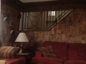

Not sure about your staircase but this works very well with a split foyer. Pix are taken from the front door and one from the stove. Works very well. hths

Bingo. As OP and you have found, a basement stove works well for some, poorly for others. The OP's test of using electric heaters to bring basement temp up to reasonable, "pellet-simulating" level for a day or so, in typical winter temps, is a great idea to help decide on the utility of a basement install. Others should try that.
Great point! Cheap experiment all and all. The warm air is going to move thru each home the same way no matter what the heat source is. Location specific of course.
