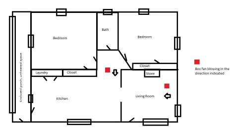

My landlord recently had a small stove (http://tinyurl.com/zl9av7r) installed in an existing fireplace and the chimney lined in my house. The stove is working well with seasoned oak (split/stacked over a year ago) but is heating me out of the house. The room the stove is in regularly gets up to 75, but the hallway stays around 65 and the kitchen between the two somewhere inbetween. I keep at least one bedroom closed (the one behind the kitchen), usually the bathroom and second bedroom as well. I suspect that although it's a small stove it's bigger than the space it's heating. I have no ceiling fans but am using two box fans to try to push/pull air around the house. Any thoughts on things I could be doing differently to create not such a wide temperature gradient? I do open the second bedroom a few hours before going to bed but it does not seem to create a measurable difference in the temperature in that room, or in the house overall. Thanks for any thoughts you might have.
(I made a diagram of the house, but it won't upload so if you have any suggestions on how to fix that please let me know)

I wish I could figure out why my diagram won't upload for then you would see I am doing exactly that.

You might try turning one fan off. try it with the one fan that is running right in the doorway to the stove room, on the floor, blowing cold air along the floor towards the stove.
