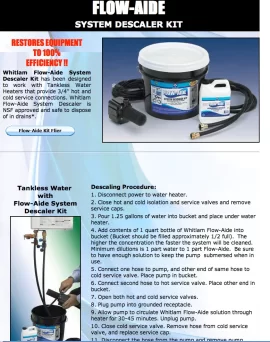

Maybe invest in one of these kits. http://www.flow-aide.com/
They were designed to flush tankless heaters. Cut in a couple Webstone valves so you can easily tap in and flush.
