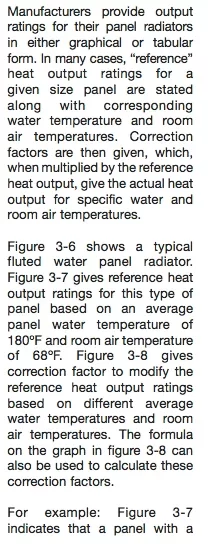

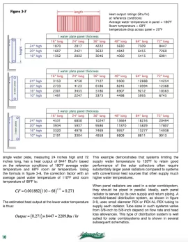

The heat loss number and the derate table for the radiator. Here is a typical table and the explanation.
  • [Hearth.com] Heat Loss for Panel Radiators
At 140℉ and a room temperature of 72 I got 1700+ after plugging in the number
