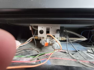

Hi all, we've had an extremely reliable Heat n Glo model SL-750TR-IPI-E fireplace in our "new build" (now 14 years old). Well last night our fireplace flame kept turning off intermittently...and today after starting up just fine the unit turned off again after 10 seconds and has "died". Can't hear the igniter/pilot attempting to turn on at all when we flip the switch.
Since it is an older unit now, is it possible it needs some sort of new component like a new igniter? Or some electrical part needs replacing? Or could it just need a good cleaning? Just trying to figure out if there's any easy DIY stuff I can do to not only save $$ but time, no idea when we could get a technician out here.
Any advice would be greatly appreciated. Thanks!

Please take pictures that show what components are in the valve cavity, & what the pilot assembly looks like without the log set in the firebox. Post them here so we can help you resolve the issue.

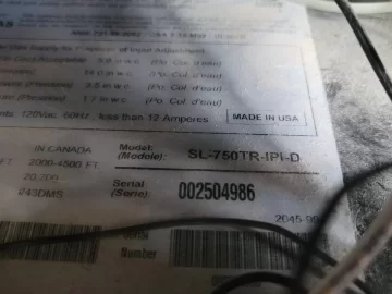

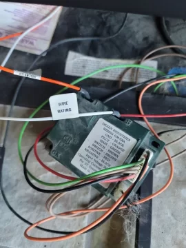

I am having a similar problem on my SL-750TR-IPI-D. The system kept chugging, so I replaced the pilot assembly and the dexen GM-6KA module. Worked great for about 3 hours, then I heard an audible pop and now it is doing the chugging thing again everytime the system warms up

Replaced the qhole pilot assembly. Cleaned the burners, checked all the connections tight (I have a background in hydro/mech systems, including O2 gen and other systems involving conrrols) controls. There isnt a good trouble shooting guide for this. I have a serial number that should be a post 210. However the parts mat h yhe pre 210 parts.... My next step would be to replace the valve, but I dont want to do that if ai don't need too....
