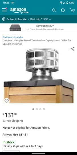

This is the cap I have. It is free of any creosote on it.
If its truly clean your good to go. That cap looks very susceptible to buildup on the inside. My opinion only. Not saying its dirty inside but have you popped it off for a visual since these troubles started? Possibly worth a peek. Good luck.
I've got the same fireplace and same cap. I hate that cap. It plugs up with creosote like nothing else and it's a bear to clean. It's also HUGE for no obvious reason, which makes taking it down for a scrub a real pain. Mine's also starting to corrode badly, so I'm aiming to replace it with something less awful next year when I go up to clean it. I'm open to suggestions.
