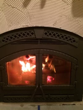

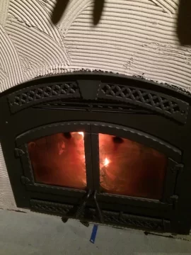

Yea thx. Its frustrating to see a brand new unit do this though. Im convinced theres a reason. The two spots are too symmetrical. Lining up perfectly with the rivets. I put a call in to tech. Waiting on a reply. But im sure i read on a forum that a guy who had a lot of experience installing these units said there was a way to adjust the air wash. Im trying to figure out how to post a few pics.

Looks exactly like mine, down to the soot spots :). If you manage to adjust the airwash, let me know - I'd love to get rid of those too.

Be sure to leave about a 1/4" gap around the front facia of that unit that isn't touching any stone so it has room to expand and contract with the heat.

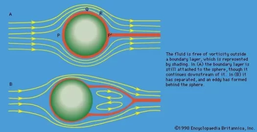

yep, those dots look familiar. i would agree that something as simple as a rivet could be the cause --- much akin to any fluid dynamic model with an obstruction and an eddy.

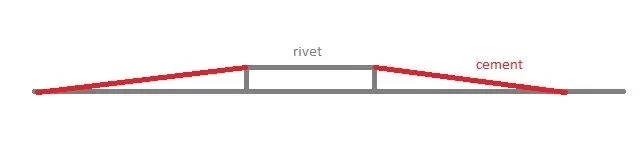

just apply the paste around the abrupt edges of the rivet. instead of a 1/4" diameter rivet that sticks out 1/8", you could take the cement and make a more gradual bump, maybe 1" in diameter.

I still dont follow you. Sorry. Have you looked at your northstar airwash slot? Do you see the problem. ? I. Not sure were on the same page

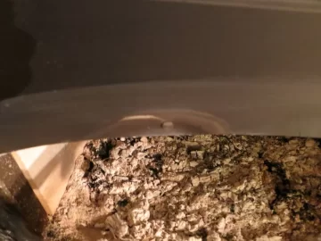

see attached pics.

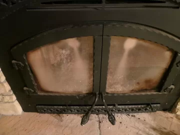

this was the fireplace after an overnight burn left to die out (hence the clouded glass)

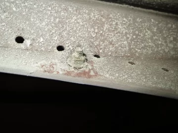

you'll see a black rivet on the front of the metal frame. it looks to me to clearly have the signs of what's causing the streaks on the glass. the other pic is the backside of that rivet with a threaded end and a nut. while that side would seemingly be in the path of the air wash, it doesn't have the telltale sign of being the issue. of course, air could be getting THRU the hole for the rivet/threaded stud and that's what's causing the issue.
so, my possible solution would be to apply chimney cement on both sides of it. smooth things out. close up air leaks if there are any.
thoughts?

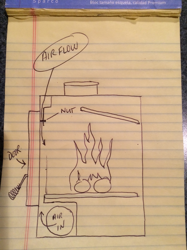

Could the stud not be just cut quite a bit shorter? It looks like there's a lot of extra thread poking out?
No. The problem is not the threaded nut. The airwash air flow is between the steel plates. Look at your unit. Open the doors snd stick your head down there and look up. The air is brought into the unit through a boxed out area and directed up each side and then down and out over the glass. Its only a thin 1/8 of a gap . The rivet/spacer is through that airwash. Understand? Cement will do nothing
